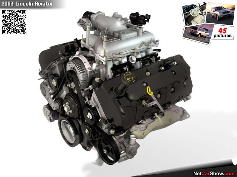

И уж коль коснулось моторов, вот...найдите 5 отличий 8)
Авиатор
Этот Кобра мустанговская
Alexrec
а че их искать? Вот на что ставились моторы Modular V8
1993–1998 Lincoln Mark VIII, 280 hp (209 kW) and 285 lb·ft (386 N·m)
1995–1998 Lincoln Continental, 260 hp (194 kW) and 265 lb·ft (359 N·m)
1996–1998 Ford Mustang SVT Cobra, 305 hp (227 kW) and 300 lb·ft (407 N·m)
1997–1999 Panoz AIV Roadster, 305 hp (227 kW) and 300 lb-ft (407 N-m)
1995–1998 Lincoln Mark VIII LSC, 290 hp (216 kW) and 295 lb·ft (400 N·m)
1997–1999 Marcos Mantis GT, 320 hp (239 kW) and 317 lb·ft (430 N·m)
1999–2002 Lincoln Continental, 275 hp (205 kW) and 275 lb·ft (373 N·m)
1999/2001 Ford Mustang SVT Cobra, 320 hp (239 kW) and 317 lb·ft (430 N·m)
2000–2001 Qvale Mangusta, 320 hp (239 kW) and 317 lb·ft (430 N·m)
2003–2005 MG X-Power SV, 320 hp (239 kW) and 317 lb·ft (430 N·m)
2000–2009 Panoz Esperante, 305 hp (227 kW) and 300 lb·ft (407 N·m) [10]
2003 Ford Mustang Mach 1, 305 hp (227 kW) and 320 lb·ft (434 N·m)
2004 Ford Mustang Mach 1, 310 hp (231 kW) and 335 lb·ft (454 N·m) [11]
2003–2004 Mercury Marauder, 302 hp (225 kW) and 318 lb·ft (431 N·m)
2003–2005 Lincoln Aviator, 302 hp (225 kW) and 318 lb·ft (431 N·m)
2003–2004 Ford Mustang SVT Cobra, Iron block, Supercharged, 390 hp (291 kW) and 390 lb·ft (529 N·m)
